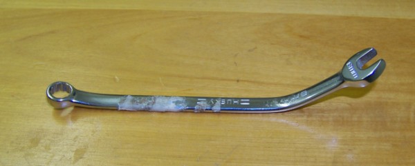

DWSUDEKUM Posted January 7, 2016 Report Posted January 7, 2016 You might wish to look into this: Running rough from Kip Scrollin' with an Ex-21 http://tidewater-creations.com In recent months it has slowly but surely started running rough. Not really a vibration like before but seems to be in the upper arm. If I lift up on the arm the sound and vibration stop. I didn't realize how bad it had gotten until today when the speed control knob started clanging and I tightened set screw to fix it. Took note stock of the situation and realized how bad things are.An update...decided to wait till after the holidays to phone Ray @ Seyco as I was sure this was going to be a long process that involved taking the machine apart and tracking down various potential issues.Well of course I was wrong and it took all of 1 minute for Ray to diagnose...LOLDid have to modify a wrench but all is wellMy problem developed over time and it's best described as running rough with sounds and vibration getting much worse as speed is increased. At full speed the quick release lever would pop open. The repair was simple: remove cover from back of saw opposite motor and tighten screw in cut out area. If screw continues to turn you must apply a modified 8mmwrench to the back side and hold bolt. Tighten firmly.As shown you must add a "bend" in the wrench. You can heat it and bend it in a vise or take a hammer and beat the tar out of it. I fully recommend the later as it works great and is a stress reliever as well I have added pics in case this wasn't clear. DW oldhudson, amazingkevin, Russell Ball and 3 others 5 1 Quote

amazingkevin Posted January 7, 2016 Report Posted January 7, 2016 You might wish to look into this: Running rough from Kip Scrollin' with an Ex-21 http://tidewater-creations.com In recent months it has slowly but surely started running rough. Not really a vibration like before but seems to be in the upper arm. If I lift up on the arm the sound and vibration stop. I didn't realize how bad it had gotten until today when the speed control knob started clanging and I tightened set screw to fix it. Took note stock of the situation and realized how bad things are. An update...decided to wait till after the holidays to phone Ray @ Seyco as I was sure this was going to be a long process that involved taking the machine apart and tracking down various potential issues. Well of course I was wrong and it took all of 1 minute for Ray to diagnose...LOL Did have to modify a wrench but all is well My problem developed over time and it's best described as running rough with sounds and vibration getting much worse as speed is increased. At full speed the quick release lever would pop open. The repair was simple: remove cover from back of saw opposite motor and tighten screw in cut out area. If screw continues to turn you must apply a modified 8mmwrench to the back side and hold bolt. Tighten firmly. As shown you must add a "bend" in the wrench. You can heat it and bend it in a vise or take a hammer and beat the tar out of it. I fully recommend the later as it works great and is a stress reliever as well I have added pics in case this wasn't clear. DW Thank you so much ,as far as i know the Excaliber and the dw788 are basically the same workings.So it should apply to both machines for this problem Quote
SCROLLECTOMY Posted January 7, 2016 Author Report Posted January 7, 2016 Thanks so much for the info. I tried tightening this bolt on my machine, altered an 8mm wrench and found that the bolt was already really tight as I could not tighten it any further. So still have the vibration unfortunately. Will have to go back to the company I purchased it from and see if they can solve it. Thanks Quote

Young_Scroller Posted January 8, 2016 Report Posted January 8, 2016 hey sam if I read DWs reply right he said just hold the bolt not to actually tighten the bolt but the screw, and if the screw keeps turning the hold the bolt with the wrench and continue to tighten the screw Quote
heppnerguy Posted January 8, 2016 Report Posted January 8, 2016 That is what I got from the post too. It looks to me that the screw DW is referring to, is the one that has the allen wrench in it. I did not even notice the allen wrench until I looked at the third photo. Dick heppnerguy Quote

SCROLLECTOMY Posted January 10, 2016 Author Report Posted January 10, 2016 Thanks guys I will let you know how it all works out. Thats the exact screw I tried to tighten (As in the photo's) If I do not hold the nut at the back with the wrench the screw will turn freely. But when I hold the nut at the back with the wrench I cannot move the screw at all. It seems to be locked tight. Have a guy gonna look at it tomorrow, fingers crossed Quote
