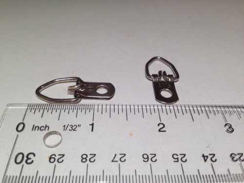

NC Scroller Posted October 13, 2015 Report Posted October 13, 2015 I used D-hangers attached with #6 1/4" pan head screws. I get my screws from Ace Hardware. The trick is putting the hanger where the wood is thicker. If you can't find a spot, glue an aditional small 1/8" strip to the back. Quote
danny Posted October 13, 2015 Author Report Posted October 13, 2015 I JUST LOV BEING A PART OF OUR SCROLLING FAMILY HERE. LEARNED SEVERAL TIPS I HAD NEVER THOUGHT OF. KARL THANKS FOR YOURS AS I CAN SEE THIS BEING OVER ALL MY ANSWER TO THIS SITUATION OF HANGING THINGS. I HAVE THESE "D"-HANGERS. BEEN IN THE DRAWER FOR YEARS. LOL THANKS TO ALL.... Danny :+} LarryEA 1 Quote

Fab4 Posted October 14, 2015 Report Posted October 14, 2015 I used D-hangers attached with #6 1/4" pan head screws. I get my screws from Ace Hardware. The trick is putting the hanger where the wood is thicker. If you can't find a spot, glue an aditional small 1/8" strip to the back. Such a simple solution by adding the 1/8" strip. but yet it never entered my mind to do this. Thanks for the great tip. I always nipped the spikes off of the hangers and used glue. Not anymore Fab4 danny 1 Quote
