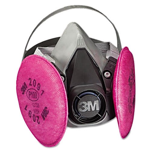

NC Scroller Posted October 25, 2016 Report Share Posted October 25, 2016 MDF dust is bad that is why I seldom use it. If you are using a dust mask and your glasses fog it mean your mask is not fitting properly and moisture is escaping and more importantly dust is entering. I use a 1/2 half respirator made by 3M. It seals well and the filters are replaceable. https://images-na.ssl-images-amazon.com/images/I/51uWB1uxxcL.jpg LarryEA 1 Quote Link to comment Share on other sites More sharing options...
