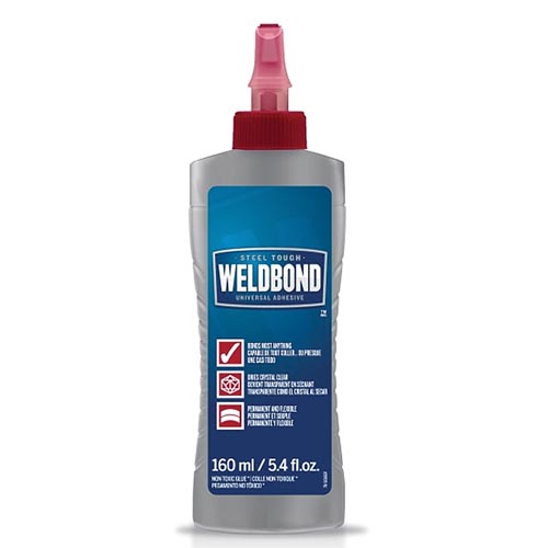

Dave Monk Posted October 17, 2018 Report Share Posted October 17, 2018 4 hours ago, JTTHECLOCKMAN said: Question?? While we are on the subject of painting projects for those that do paint, do you glue the pieces together before you paint or do you paint and then glue the pieces together??> If you do the second then what type glue are you using and do you find it to work well and not have items break free??? Does it matter if the paint is one kind or another when gluing?? Thanks in advance. I always paint my stuff and then glue together with Weldbond glue. I have tried them all and this holds the best for me. After it is glued I spray the whole thing with clear lacquer. John B, JTTHECLOCKMAN and tomsteve 3 Quote Link to comment Share on other sites More sharing options...
JTTHECLOCKMAN Posted October 18, 2018 Report Share Posted October 18, 2018 9 hours ago, Dave Monk said: I always paint my stuff and then glue together with Weldbond glue. I have tried them all and this holds the best for me. After it is glued I spray the whole thing with clear lacquer. Dave any particular type??? Quote Link to comment Share on other sites More sharing options...
kdparker Posted October 18, 2018 Report Share Posted October 18, 2018 I agree with Dave Monk. I paint all of my backerboards first then use Weldbond glue. The Weldbond dries very clear and bonds well. I have never had any joints to separate. It has become my go to glue for scrollsaw projects. Check Amazon for different size containers of Weldbond. Quote Link to comment Share on other sites More sharing options...
Dave Monk Posted October 18, 2018 Report Share Posted October 18, 2018 7 hours ago, JTTHECLOCKMAN said: Dave any particular type??? Hobby Lobby carries it. Quote Link to comment Share on other sites More sharing options...
Tomanydogs Posted October 19, 2018 Report Share Posted October 19, 2018 (edited) I also use that same Weldbond, I like it very much. I've tried Gorilla super glue and was not very impressed. However, the black Gorilla black tape, I think it holds better then the grey regular duct tape.- Not that I'm duct taping my projects together. Edited October 19, 2018 by Tomanydogs Quote Link to comment Share on other sites More sharing options...

Frank Pellow Posted October 19, 2018 Report Share Posted October 19, 2018 I use stain on some part of most my projects and the satin of choice is Saman water based stain. One good feature of Saman is that it does not raise the wood. Sometimes, I also use paint, either acrylic which I brush on or "rattle can" spray paint. If brushing on acrylic, I usually treat the wood with either shellac or stain first. I always paint before gluing the foreground to the backer board. Quote Link to comment Share on other sites More sharing options...
