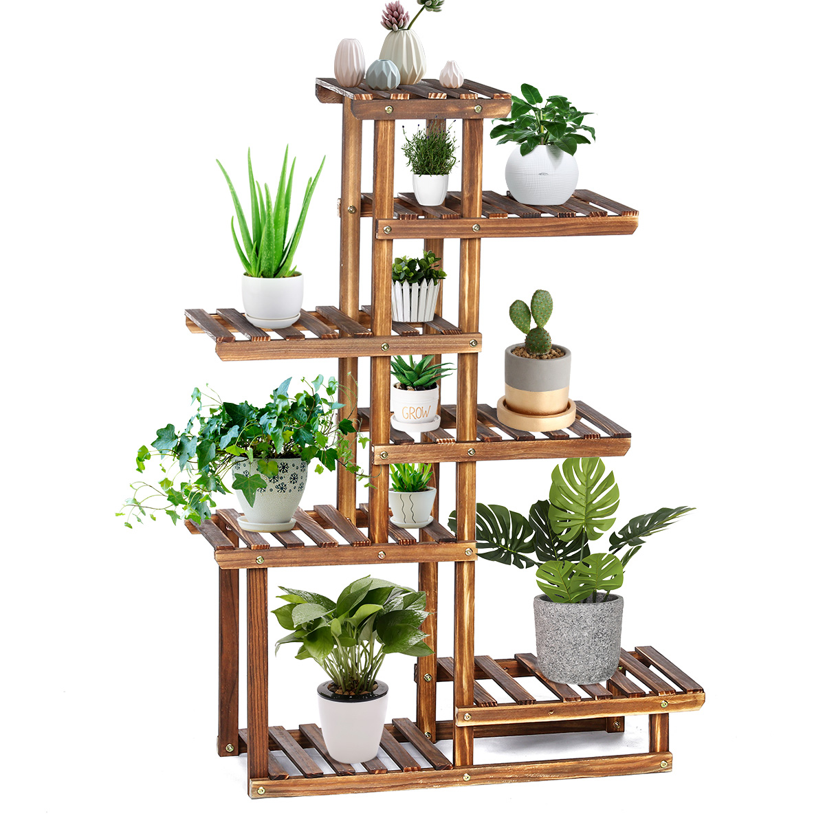

BadBob Posted May 16, 2021 Report Share Posted May 16, 2021 (edited) 18 hours ago, OzarkSawdust said: I'm making one of these for my wife. Got it cut and ready to drill holes and bolt together. The HLVP idea is to paint it white. I think this project would take a long time to paint with an air brush. There are a lot of other projects that would be nice to use one on. Like the Cancer Ribbons I do, I don't really like the finish I get from a rattle can and an air brush might do a lot better job. I ordered a Critter yesterday and that should work for this project, I'll just have to try it to see what types of projects it works best for. I want to paint the deck this summer, and will need a full sized HLVP sprayer for that. But with other needs filled I can spend less on a gun for that and the very few projects of that size. At least that is the thought. People seem to think airbrushes are only for tiny objects. I know someone who paints cars with automotive paint and an airbrush. He paints in his driveway one panel at a time. He has a wall full of trophies and ribbons he has won at car shows. For a compressor, he used a spare tire. There are many different sizes and styles for different tasks. Some airbrushes could easily be used to paint a sheet of plywood. First, you need to decide what you want to paint and what finish you want to spray with it. Then you can choose your airbrush. https://airbrushes.com/airbrushes.php Edited May 16, 2021 by BadBob OzarkSawdust 1 Quote Link to comment Share on other sites More sharing options...
